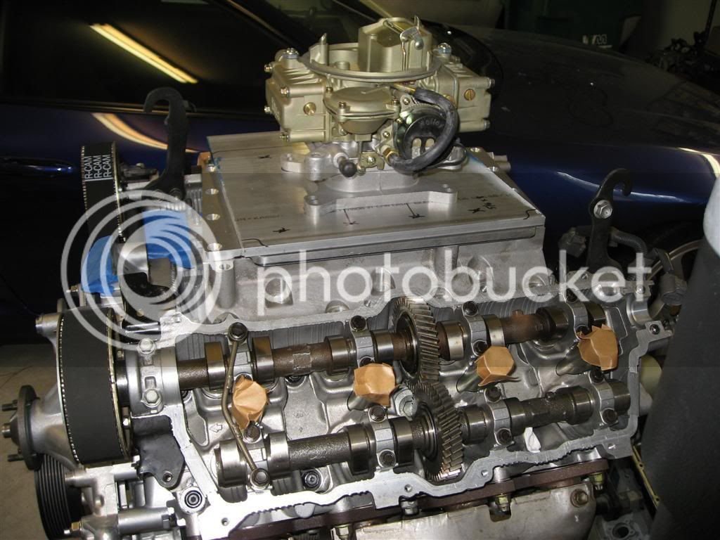

Like this?
I'm preparing my 1UZ for an engine dyno breakin with this 390cfm Holley and a distributorless ignition setup using the Ford EDIS8, controlled by a Megajolt Lt Jr. I'm hoping to finish it and get it on the dyno before the 15th of this month.
There's the Richwood manifold, with an adaptor plate and a 2" spacer for the Holley. I have no idea how the fuel/air distribution will be. Probably the middle cylinders will be a bit rich and the four corners a bit lean.
I'll either have the stock injectors or some rubber plugs in the manifold to seal it during breakin.
This setup will only be used for the motor breakin, then it's coming off and the Opcon-Autorotor SC, fuel injection, and EMS will be going on, then back to the dyno for some power runs.

Ha Ha Ha, Ok, people carb them out to break them in safely..Now that makes sense... I would think an experienced tuner would be able to dial in a stand alone ECU to break in a new built motor...Hmmm? Carb is the safest for sure though.....
390cfm carb is an eye dropper that's hillarious.... Is that a 4.0L 1uz you got there Cribbs?
A correctly made and fitted manifold should alow the Carb to distrubute the fuel evenly to each cylinder... Never thought I would see a carb setup on the 1uz-fe... This brings back fond and frusterating memories of backfires, rebuilding the carbs, jetting carbs, vacume assistant problems, choke problems, turning tiny carb screws to adjust the fuel mix, Eccel distrubutors, Holley and Edelbrock maniflods, etc... Oh the good ole days of the Carb'd SBC's...
Yeah, I thought so too; that was a $3500 mistake.
The one thing I don't want to do is overfuel this motor; been there and done that already. And remember, this is for breakin only - I'm not going to go WOT @ 7200 with it, so 390CFM should be enough for my purposes. There's no way I'm going to be trying for power with this manifold setup.
