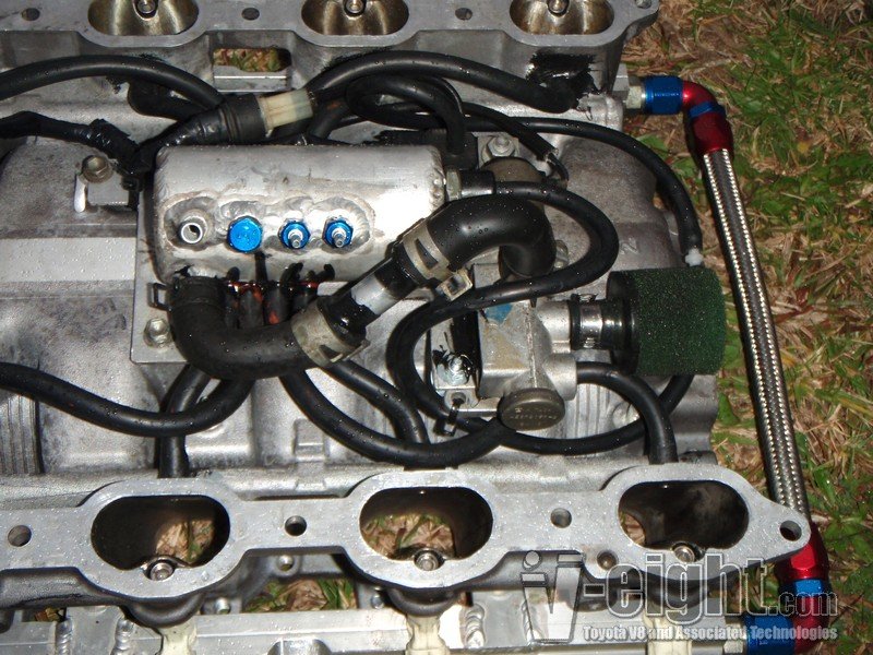

Thanks for the input guys. I'm going to use '05 Yamaha R1 TBs which have a well designed balancing set-up with vacuum lines connecting all barrels. Plus additional vac ports that I'll run to a reseviour in the V. Function will be the focus, I really don't care how it looks. Here's the Yamaha TBs
This one has an air box on it which I'll remove, but you can see the vac lines at the bottom.
