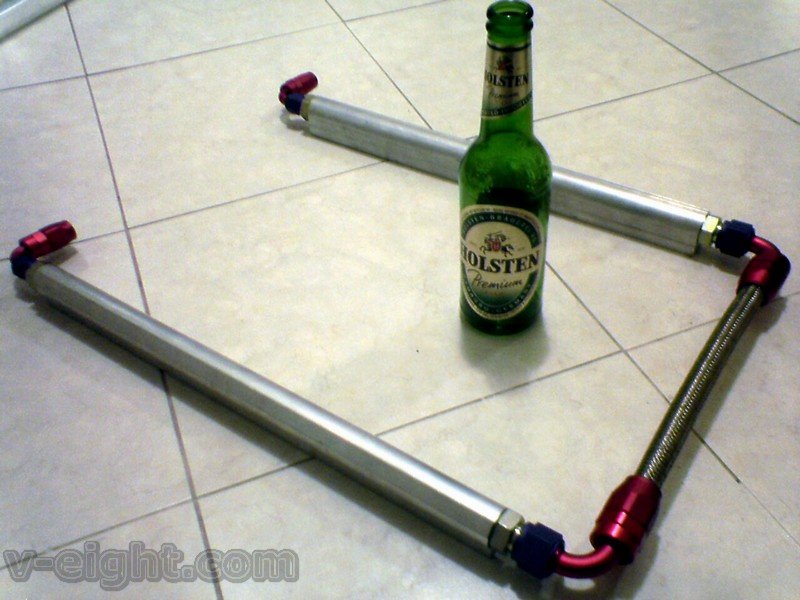

cost me about AUD$120 to make, including fittings, lines, machining and beer
"1000hp" fuel rail extrusion costs about AUD$45/m from a workshop in sydney

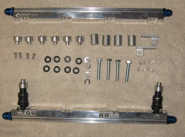

If you can do it yourself then its great way to save money, but the time, knowledge, skill and connections (knowing someone can help machining) most people don't have. Remember, these rails were designed and engineered by Wolfkatz not me. To save couple hundred bucks and possible headaches, I would just purchase it from someone who tested and documented. I did tried to make it myself, but it would cost more then I saved.

How are you holding the rails down?
Are you planning on making small plates and bolting them on (as per Wolfkratz) or some other method.
For Australian members these may be an option.
bolt on tab, or even just welded on tab (x4 of)
havent done that bit yet - havent had a manifold in front of me for a while due to other fabrication going on :)
cheers
ed

Yeah keep in mnd you need to get the fittings you want, but for two rails with all the hardware to mount, its pretty good value I think. Since there is such little R&D in fuel rails, its pretty hard to get away with hundreds and hundreds of dollars premium. Ask him for some pics or PM me your email and I will send them to you.
