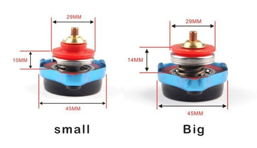

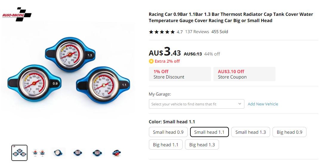

Picture is of a really neat radiator cap with an analogue temp gauge fitted to the top on AliExpress for about 5bucks
