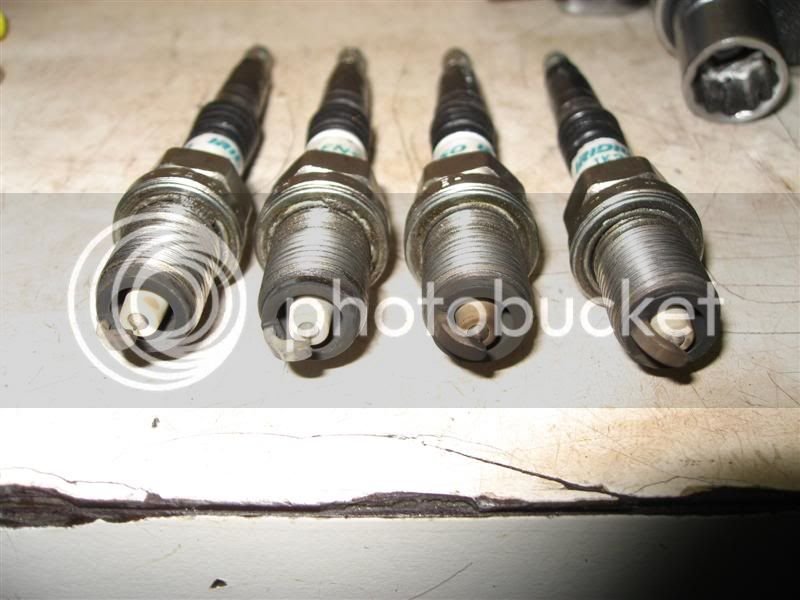

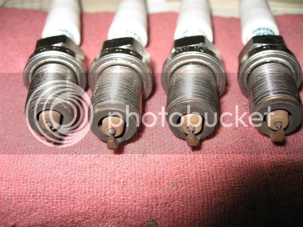

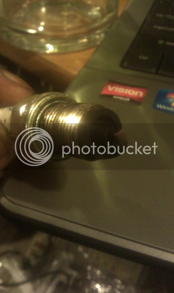

I know you said it's pumping black smoke out the exhaust, but what do the plugs look like?
