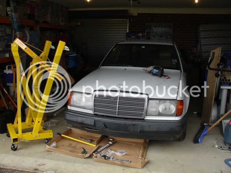

It always starts off innocently enough, Brought a cheap merc with a blown engine off ebay with the idea of fitting in a replacement engine and flogging it off again for a nice profit.

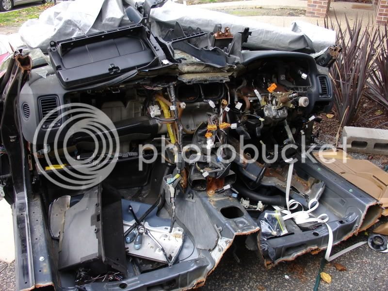

That was the easy part. Started pulling the merc apart inbetween working long hours and keeping the relationship alive. (they lose interest if you dont see them for a month for some reason) Pulling the ls400 apart i found that even though toyota pulled several german makes apart to build the lexus, they ignored most everything and built cars like the japanese do. That means nothing is compatible and alot of stuff is on the wrong side of where i need it to be. :eek5:

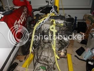

Im pulling out all of the mercedes bits behind the dash and using the toyota incl. the climate control. It will still look like a merc inside, i will use the same controls and switches hooked into the toyota loom and wire in the dash instruments. I need to change the speedo over from manual to electric operation but thats fine as i want it to read higher that 220km/h i have photos but have missplaced the card reader so will update soon.
