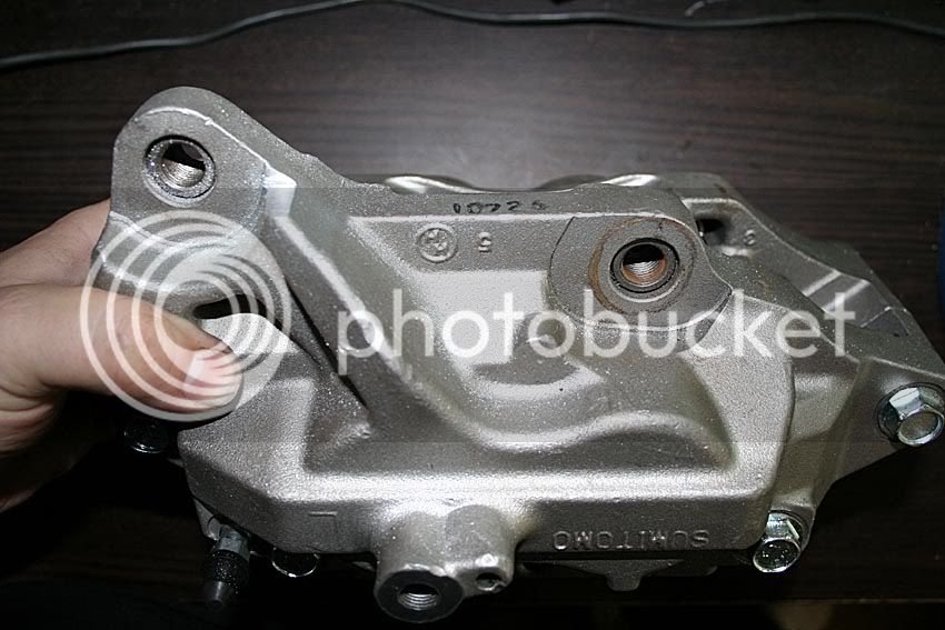

These arrived today from Lextreme, fantastic service once again:banana: They are 1995 onwards LS400 calipers and discs 315mm.

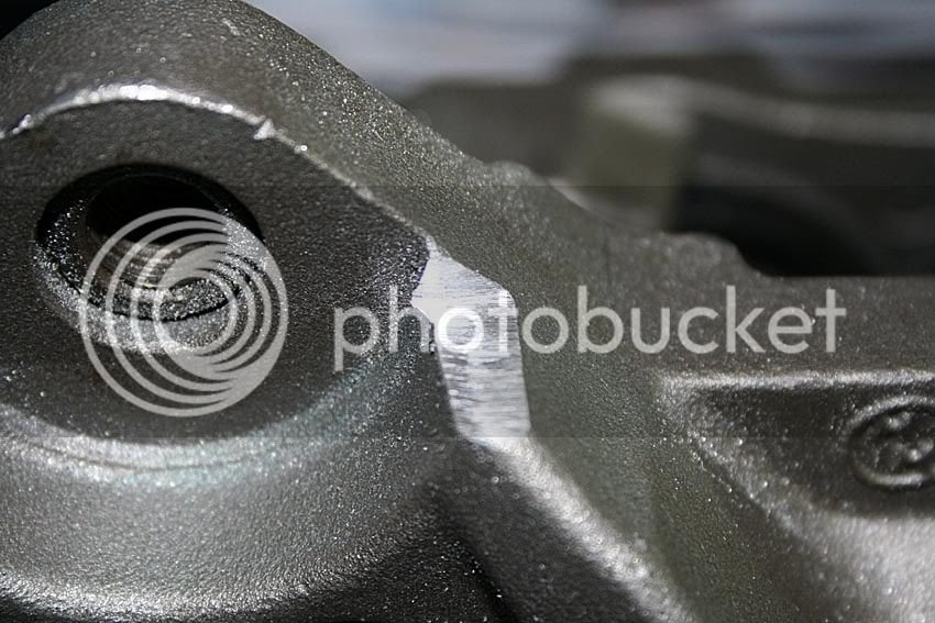

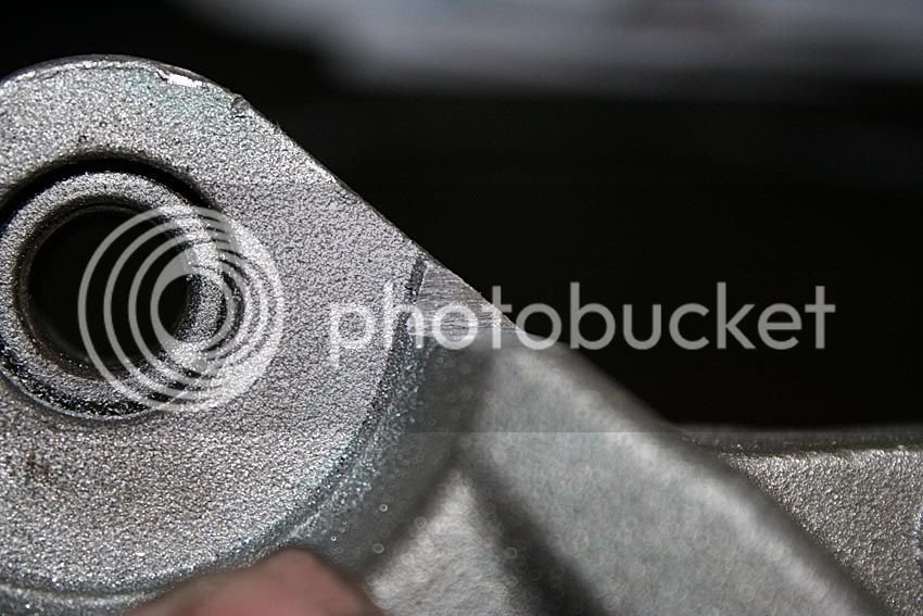

This is a trail fit. The dust sheld at the back of the disk is going to have to come off or be modded. The wheels clear the new calipers, but the calipers are going to need a gentle meeting with Mr. Grinder to make them fit the hubs, they only need about 5 or 6mm shaved off in an area where there is alot of metal, so can't see it being an issue.
Next to the old disc they look HUGE

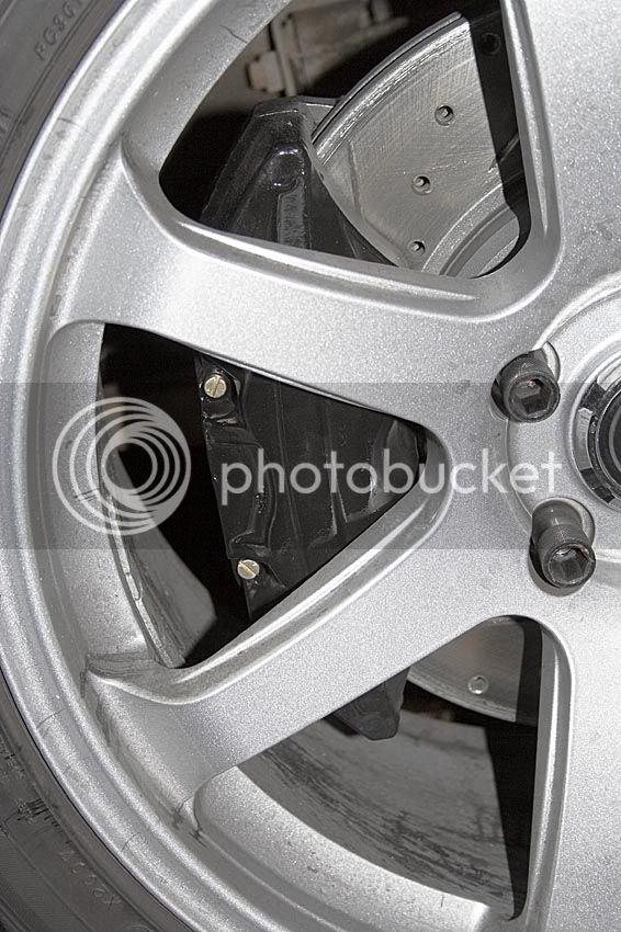

New ones
A little closer:

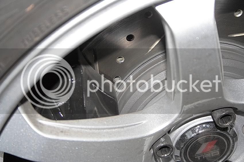

And the clearence between the caliper and wheel
Now going to grind off what's needed, spray them black (unless someone has a good suggestion on another colour) then fit with braided lines all round and DOT 5.1 fluid.

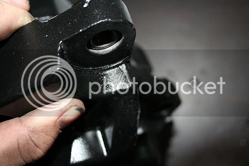

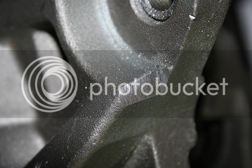

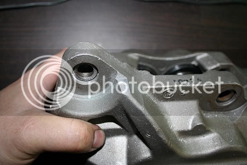

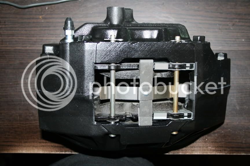

Yes thay are alloy. To fit them to the Soarer you do need to file off the bit shown in the pics below (not sure if you have to on the SC400). I've now rounded of the sharp edges of the filed bit and painted them black. Just waiting for that to dry and I'll be adding Lextreme stickers and clearcoating over them.
Well got them all fitted and new DOT 5.1 fluid in the whole system today, with stainless braided brake lines all round and gave the rear callipers an overhaul too.
My word what a difference!!!! Leaving the workshop they were crap:smash: but then they wern't bedded in. Gave them ten miles and they started to bite and on the back roads back home from Peterborough they just got better and better. Still took it easy as they're new, but but the time I got home the initial bite and pedal feel is fantastic, better than any other Soarer I've driven:) Can't wait for a dry day to take the car on a blast in the Lincolnshire Wolds, I bet I can't overheat these quickly like I could the old ones.
I had to grind off just about 1mm at the exact location as you did on the caliper. However, you don't have to grind that off on some calipers, although they're all Toyota factory. I guess that's just a minor fault in the casting process, or maybe from different manufacturers that Toyota uses. And since the LS has larger fitting area than the SC400, it won't matter anyway. I think the clear coat or any paint is too hot for the sticker glue, and it melts the glue. You may ask David for another set of the sticker. I have it on mine and it's nice...!!! You should use drilled/slotted rotors for your rear brake, too. They'll help a lot more and balance your braking effort.
