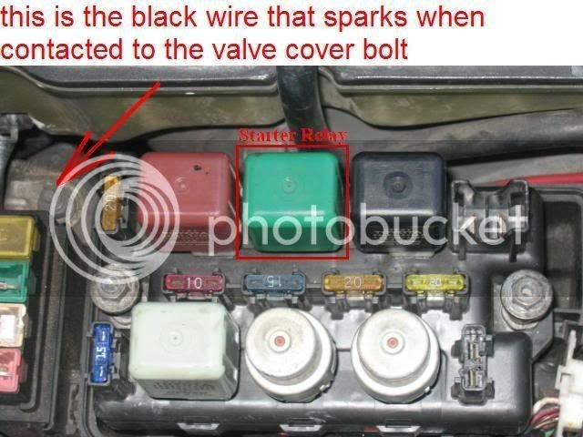

Timing belt is fine.. the squeaking is coming from the driver side camshaft distributor area. I took off the valve cover and inspected the shaft and it showed no sign of wear or metal contact. Here is the symptom.. I can get the engine to turn and even start at times however there is a point of rotation about every other 1/4 rotation of the engine that something stops the engine sticking in place and resists to turn, actually stoping the engine as if it is ceased up but if I attempt to start on then off- on then off, it moves a little at a time until it is rotating again getting about 2 rotations of the engine going then it forcefully stops and shuts down the engine once it hits that resisted rotation. I have no clue what I am dealing with here so your thoughts are greatly needed. also i was bolting the valve cover back on the engine, and when I touch and make metal contact with the front side bottom bolt and the bolted wire that is black and looks like a ground under the fuse cover with the cover off of course It sparks pretty heavily and after sparking there is a sounds like "water from a faucet" inside the top passenger side of the engine.. I dont know if this is supposed to do this normally b/c I thought this black wire was a grounded wire.
The bloack wire you refer to is more than likely the solenoid feed for the starter.
Make sure it isn't earthed or have any bare wires hanging out of it that may touch the block as this will stop the starter cranking.
All earth wires on the engine have a brown wire as a base colour.
