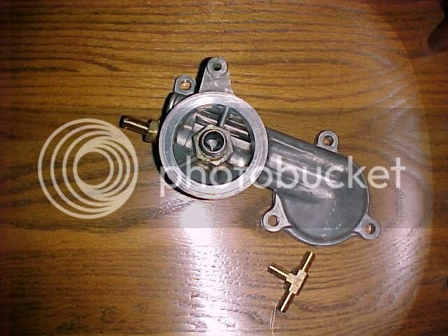

mshawari1 Member Messages 648 Location Riyadh Feb 8, 2007 #1 :smoker: I figure that this is the best way to make remote oil filter : 12 mm thickness 22 mm oil hole 8 mm bolts hole 1/2 inch 1000 psi oil hose It cost me around 55 USD
T Toysrme Member Messages 838 Feb 8, 2007 #2 Good deal! I love remove / auxillary / bypass filters. So much easier to deal with. Well worse the price of admission! The 92-96 Camry v6's have a similar OEM standoff.
mshawari1 Member Messages 648 Location Riyadh Feb 9, 2007 #3 The more important thing is the 1/2 inch hose that let more oil to pass … I see one before here making the same setup with 3/8 inch hose !!!
M Mattmannz New Member Messages 312 Location Wellington New Zealand Feb 16, 2007 #4 That looks neat, how did you get the engine side mount made? Where were the hoses fabbed up? Cheers Matt.
mshawari1 Member Messages 648 Location Riyadh Feb 18, 2007 #5 I will install that hoses going from down (Side) to the front of the engine then coming up …… I fabricate that hoses in local hydraulic shop
