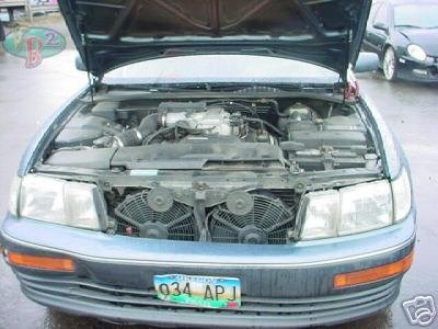

Here is a picture of the car the seller swears the engine came from. There is a little damage to the front passenger side...
can you check the engine number with lexus and get the vin number confitmed against the licence plate?
We can do this in the UK. If you have a difference then take it up with the seller if possible.
Judging by the melted plastic it's reached a considerable temperature.

Maybe I should have done that before I bought the engine. :speechless: They seller just fed me a bunch of lies to get my money. Checking the plates would be a waste of my time and cost me a couple bucks for the plate check. The seller is really not going to help me out at all. He was super nice at the beginning and then when I sent him some money he really turned on me and I really had to call him at least 60 times (no exaggeration) to get everything he promised me. I'm just going to follow through on this engine since I got it so cheap and sending it back for a refund is completely out of the question due to shipping costs. The deal was just too good to be true.

Seen something similar, 1UZ ran out of water, customer kept driving, engine siezed, plastic covers/dist caps were melted over the engine,valve seat inserts dropped out of heads !
I was afraid someone would say that =\ I hope that the engine just heated up and stopped running and melted down without burning out the internals too bad. I'm replacing all the rubber andplastic parts there are while stopping short at taking the heads off.
Thanks for the feedback Erol I appreciate it.
I have seen this may times on other engines when they suffer from extreme overheating. I would definately remove the heads and check them for warpage. I suspect you will have a blown headgasket when you fire it up. Far easier to do it now. Cheers
Yeah you're right. It's time to take a small step backwards and replace the head gaskets. No big deal and I would rather have the peace of mind. Even if the head gaskets didn't fail I'm sure they were weakened by the excessive heat.
