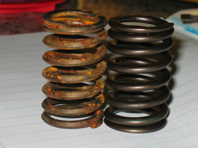

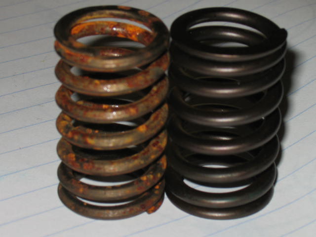

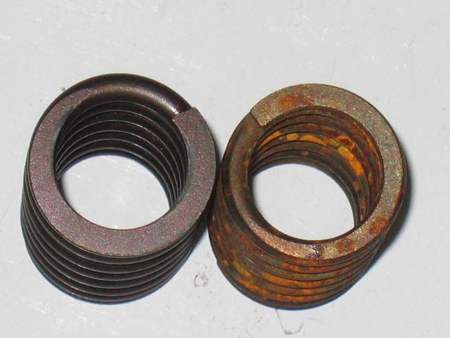

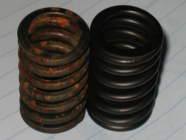

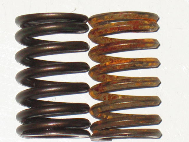

1UZFE heads. Here are come pictures of the two springs
together. The rusty spring is from my 1UZFE and the clean
black spring is from the 2JZGTE
The picture below is the resting length of the two springs.
The 1uzfe spring is slight longer.

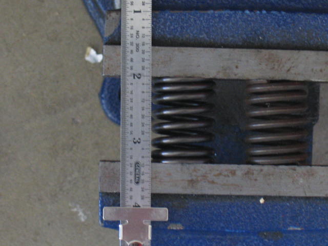

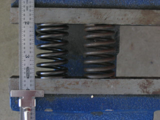

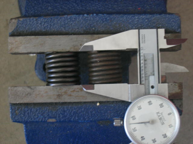

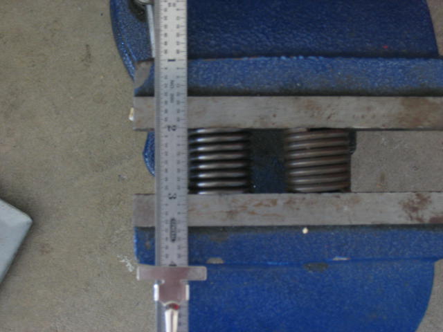

Here is a picture of two springs being compressed.
Here is a picture of the two springs are fully compressed.
Looks like the 1uzfe spring would bottom out first.
