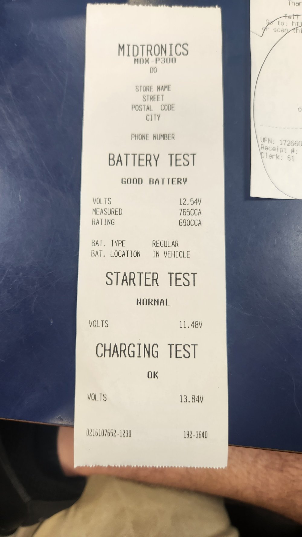

Hi Folks , 88 Cressida Guy again with another issue on this forever project
So recently the Cressida had devolved a random no crank, just a click click like the Bendix isn't extending . Since the starter was original to the engine from 95' i decided to just replaced it. I thought is was fixed ,but i was wrong.
The issue usually happens either if the car is really cold or after driving a while and its pretty warmed up. if i keep turning the key over and over it does eventually start. Im not sure what to do other than tap into the s wire and rig a momentary switch for testing when it acts up. I want to believe the Ignition switch is the problem as I have not changed anything in the way the harness is wired.
Any help from the community would be much appreciated . I really dont want to pull the intake again
