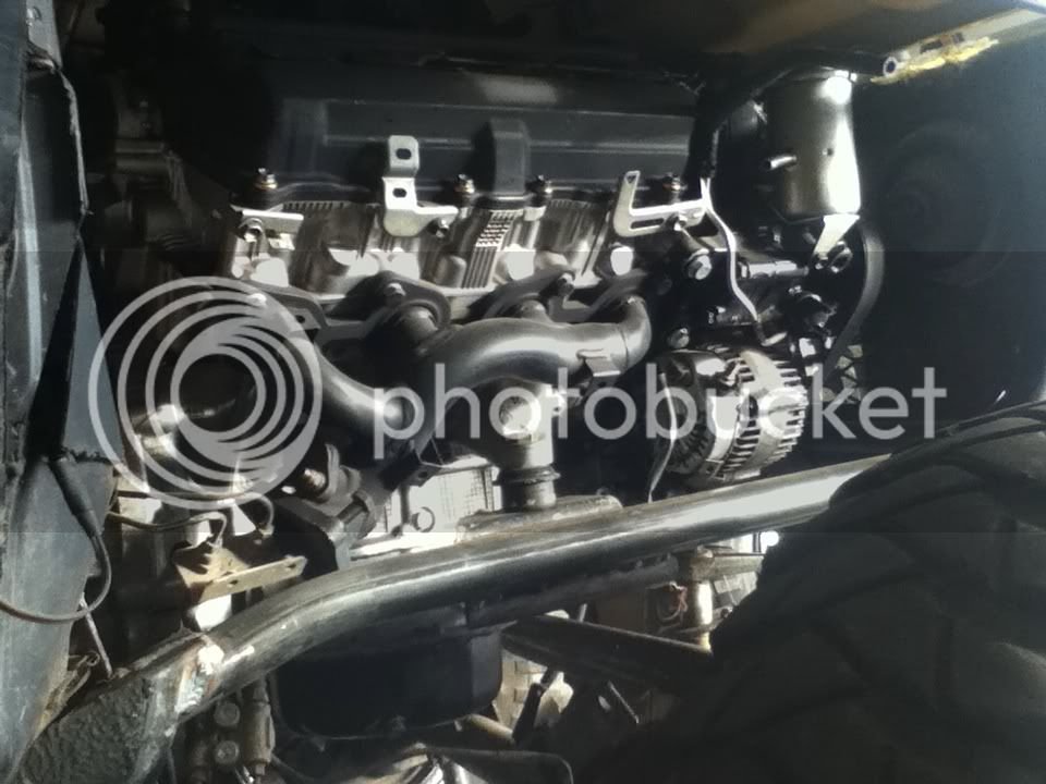

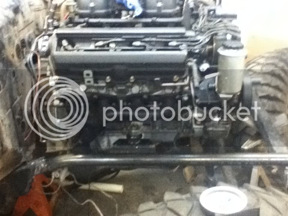

any pics of the engine bay ?
its tight.
https://quantum-auto.com/ sells some flanges i might just make my own it would help me anyways do these motors need back pressure ?
with the suspension i want i really have no room for mufflers and crap but dont wanta run just open headers because of noise.. but no cat or muffler should pick up a few ponys shouldnt it?

These motors on stock ECU make between 135-150rwKW with a manual box. This figure is based on the 20-25 1uz powered vehicles that have run on my workshop dyno. (I dont really want to get into the whole dyno rating thing). Pretty much all the vehicles I do are conversions so have different exhaust and free flow intakes. Generally these have stock , log style or stock shortened manifolds.
With aftermarket ECU (Link storm) I expect to get 165-175rwKW. Did a megasquirt and got 160. These vehicles also have my designed performance headers which free flow intake. The one with the best torque ( which would suit your application) had my headers flowing into twin 2 1/4 inch pipes flowing into single 2 1/2 inch with good quality mufflers.
I would recommend keeping it simple with good quality aftermarket ECU, good long headers and conservative exhaust.
After that I would swap to a 1uz VVti motor which produce more power with stock ECU than a early motor with aftermarket ECU.
When chosing the ECU for your present motor I would get one which can easily handle the VVti ( and control it correctly) on the later motor. VVti motors share blocks so will mount in the same place, headers interchange as do oil filters and sumps etc. The VVti is flater across the back of the heads so can be mounted back further is the main difference.
Best bang for buck in my opinion is starting with the VVti motor. Cheers

You already have a motor so I think you should get it into your truck and get it running. While doing it "future proof" your vehicle by getting an ECU that will handle VVti.
Donts go too big on your exhaust as it will cost you torque.
And I wouldnt spend too much money trying to extract more power out of the early motor. Do the basics and then save for a motor with more power. Its going to be a big change from what you had before and you will need to allow your driving style to adapt to the new power plant.
By the looks of where you drive torque is going to be far more important than top end power. Cheers
