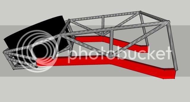

heres a picture of my race truck. give you an idea of what im working towards
and the rough design of my rear cage
