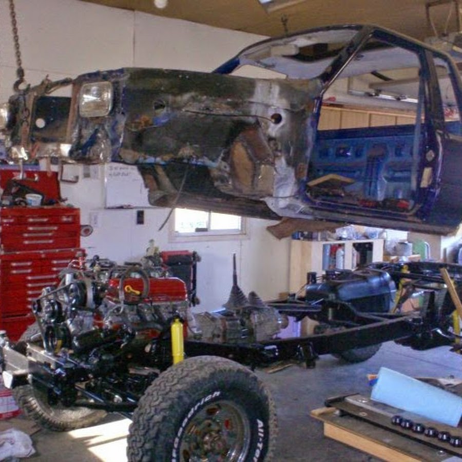

Here is a few pictures from 10 years ago just to set the stage.
