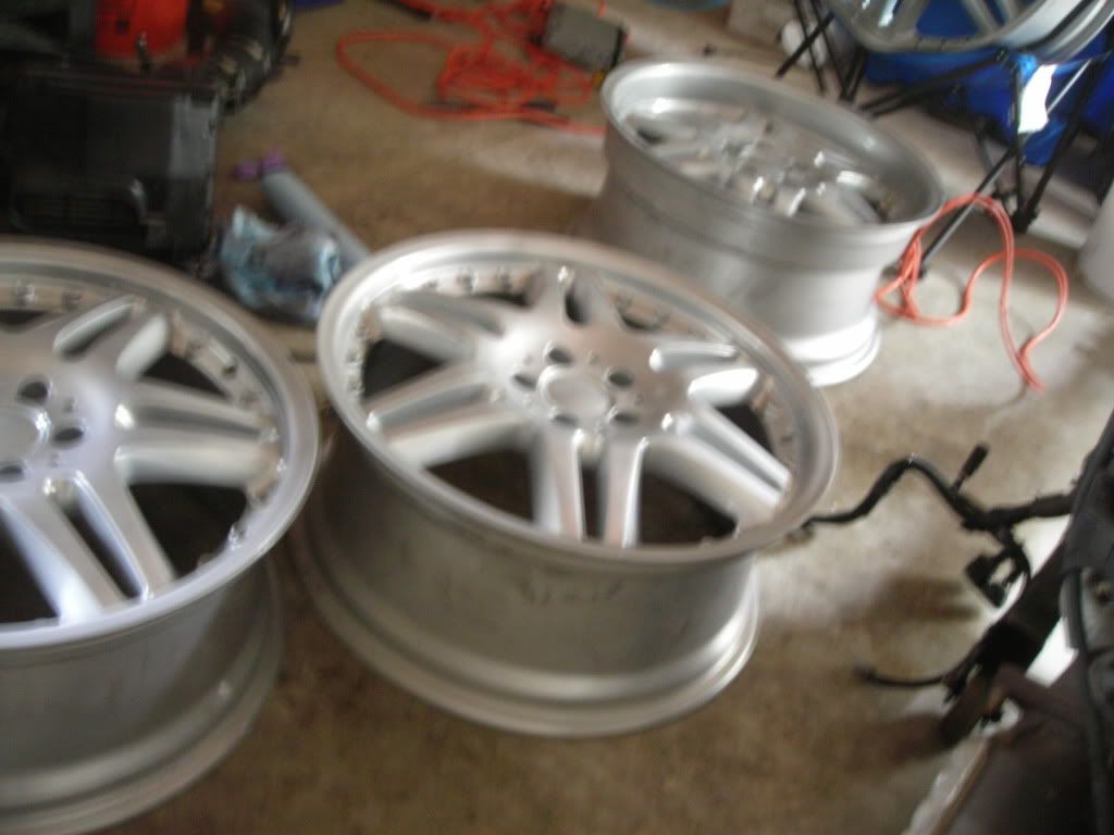

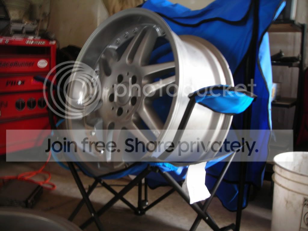

Just grabbed a nice set of Brabus Monobloc IV's replicas and need to know the widest tires I can fit with these offsets:
Front:
19x8.5'' with 35 offset
Rear:
19x9.5" with 38 offset
I'm hoping to fit a 245-35 in the front and a 265-35 in the rear.
